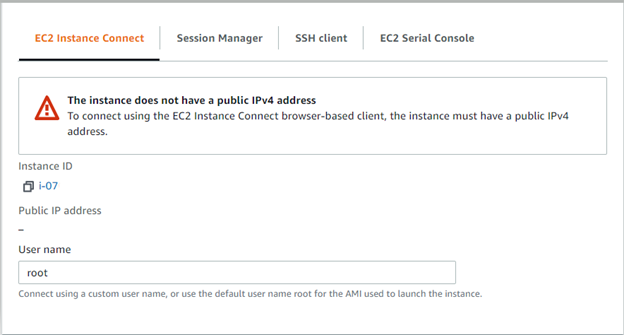

Let me build out the scenario here. Your company is taking a cloud first approach to the IT infrastructure, and as a result one of the first servers to be moved to the public cloud (in a private VPC) is the IGEL Universal Management Suite Server. To reduce cost, we chose to install the UMS on an Ubuntu Linux server without GUI. If you are familiar with AWS, the ‘console’ access to Linux servers is generally only available via SSH.
As you can tell from the screenshots above, the only method we have to access the server is via SSH. Out of the box, SSH really does not have any “fancy” GUI available, so let’s change that.
