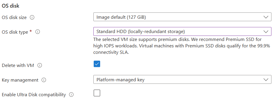

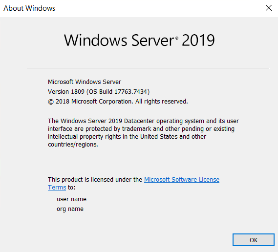

One of the things I have always wondered about was if the cost to use SSD or Premium SSD justifies the cost compared with standard HDD, or spinning rust as it is known, so I thought I would benchmark them! First up is what should be the slowest of them all, the HDD Standard Disk Tier, which is also the cheapest of them all for obvious reasons. All of the tests will be performed with the smallest disk size available, and on a standard D2s v3 VM type (Standard_D2s_v3), which has 2vCPUS and 8GiB of RAM. The OS used for all of the testing is Windows Server 2019, which has been fully patched.

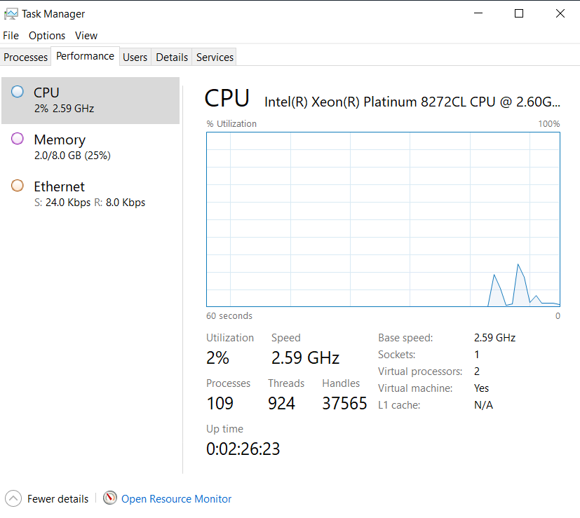

For the first test on the Azure VM, as soon as I RDPed into the server, I notice that the VM felt 'sluggish', but that could me having a subconscious bias. Here is what Task Manger looked like.

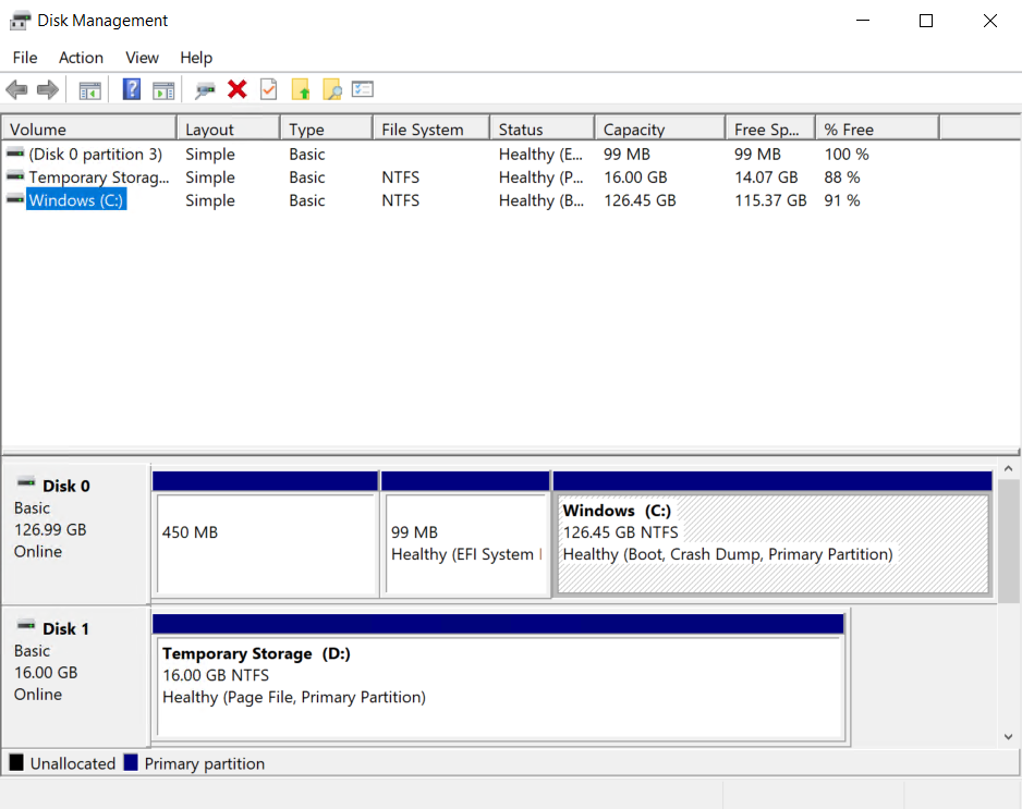

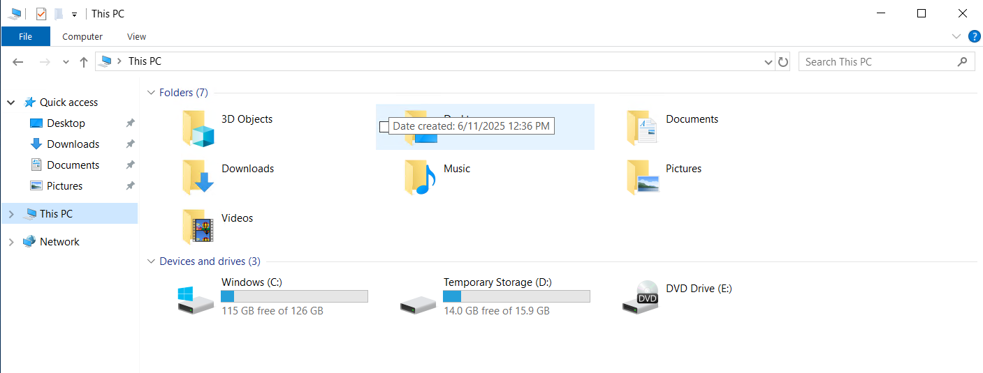

As you can see, the VM is pretty much idle, but clicking around, things felt a little 'off'. Below is a picture of the disk chosen for this benchmark.

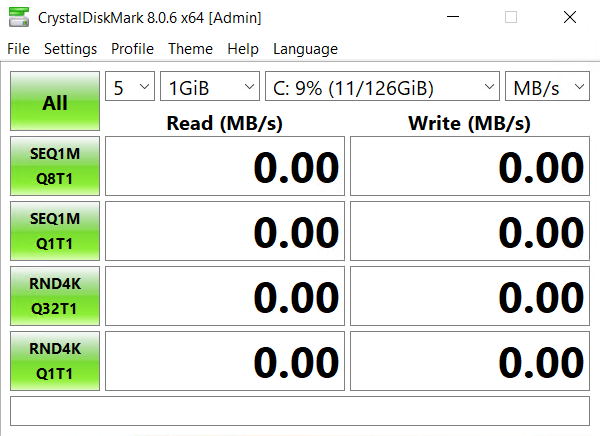

We then download CrystalDiskMark 8.06 and install it. We then reboot to ensure there is nothing that can interfere with the benchmark, which we will run three times, all at default settings.

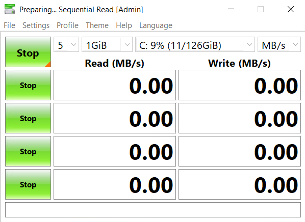

Then we let us run!

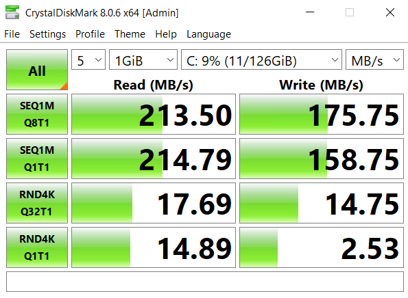

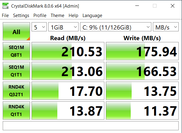

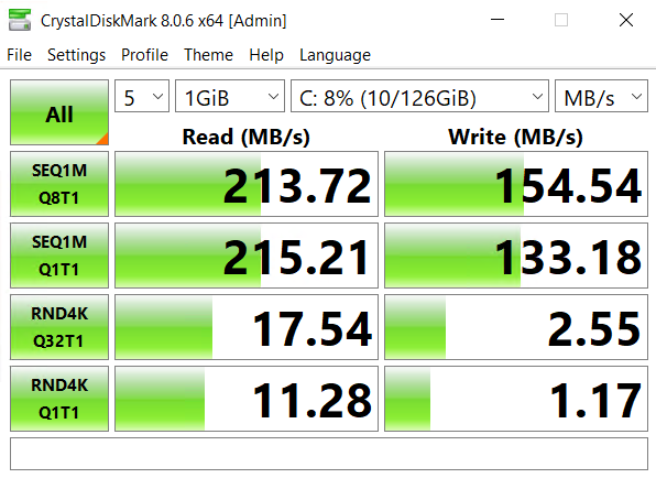

The first round of results is in, and to be honest, the benchmarks of the Standard HDD offering, is much better than I thought.

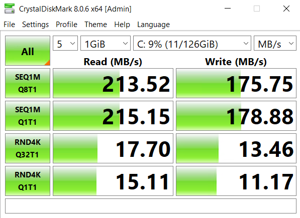

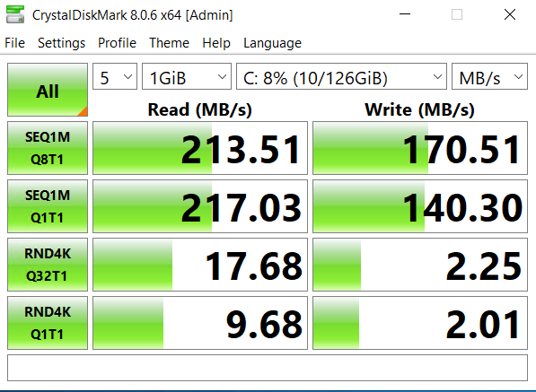

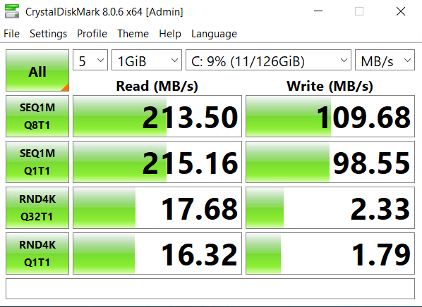

So, let's reboot, and get on with another test. The results of round two are below.

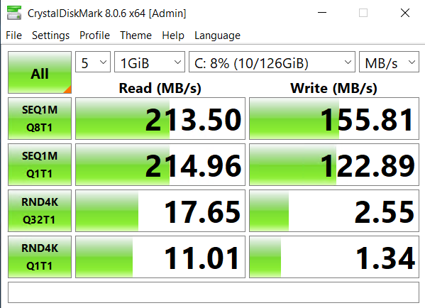

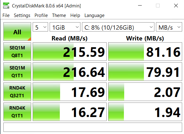

And for our final run of the HDD benchmark, here are the results.

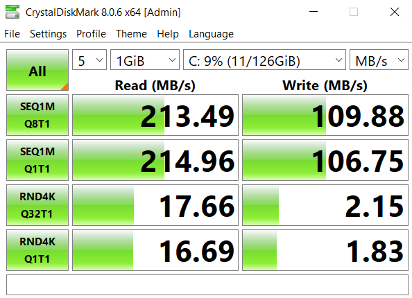

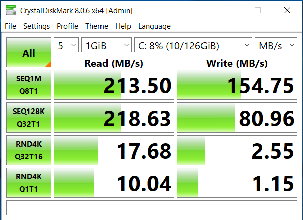

So, the first run is not exactly what I was expecting. I assumed the SSD numbers would be much different than what we had seen for the HDD attached storage. Let's see what run number two brings us.
Round three does not bring any major surprises.
After wondering why, the SSD results were so similar to what we were seeing for HDD, I thought that I should have poke around the settings (a.k.a nerd knobs) within the Crystal Mark tool, and look what I found
So, let's enable NVMe SSD and re-run the tests to see what numbers we get.
Well, that did not change much at all. Time to move onto Premium SSD. To see how the most expensive disk performs.
