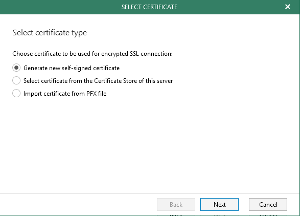

Give your Azure AD Application a name, and select to install a certificate by clicking install.
As you can see from the screenshot, we are going to generate a new self signed certificate
Ensure you have the code that is shown in the screen shot above. Yours will be different than mine. Proceed through the authentication steps. Obviously, I cannot show them here for security reasons. If you have done everything correctly, then you should see the following.

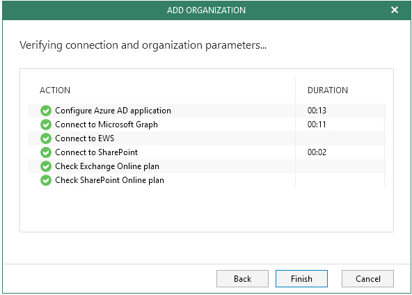

Once you hit next, VBO will begin configuring the application in Azure AD.
If everything goes as planned, then you should see something like this.
Hit finish, and you now have an organization configured in Veeam Backup for Office 365, so we now need to get on with configuring our first backup job.
