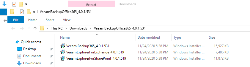

With all that in place, let’s go. We first need to download the software from Veeam at this URL. Once downloaded, you will need to extract the three files contained in the zip file

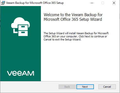

We then need to run the main Veeam.Backup executable to kick off the process.

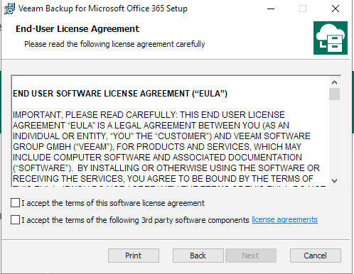

Accept the standard EULA

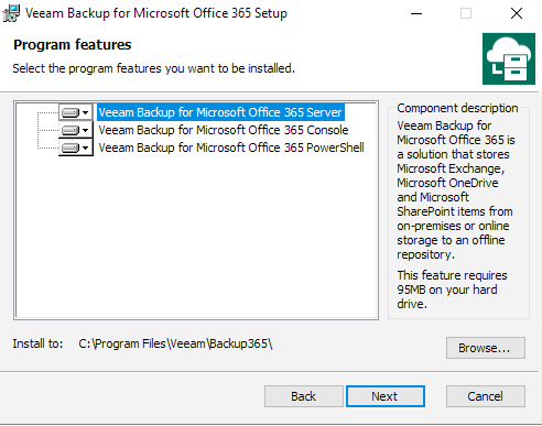

Install the required components.

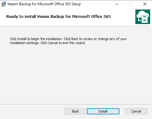

Click Install

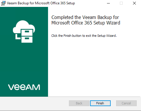

Let the installer do it’s thing. Eventually you will be presented with this screen if all goes as planned.

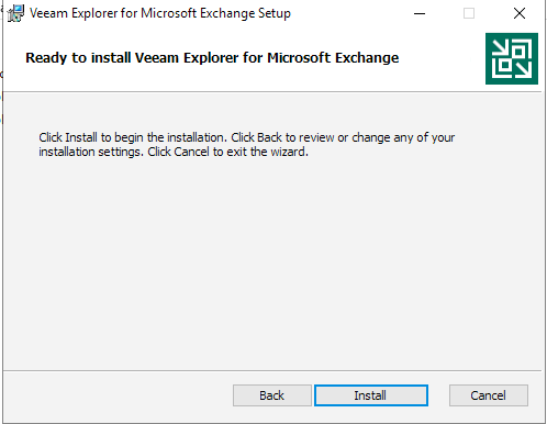

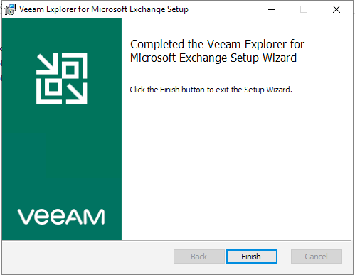

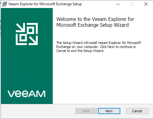

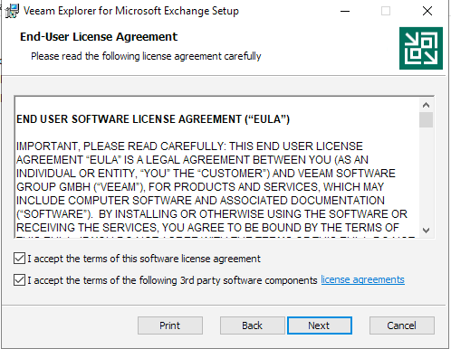

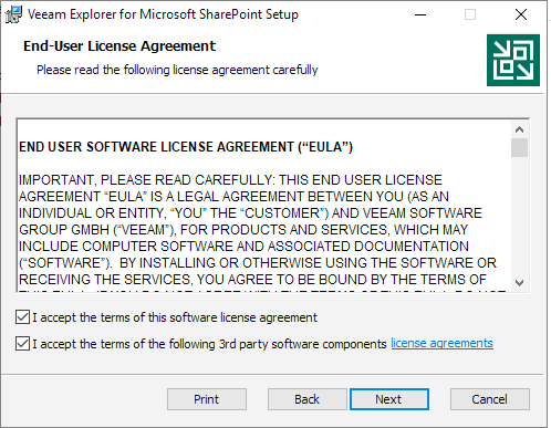

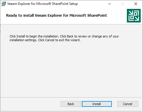

Now we need to install both the Exchange and Sharepoint executables.

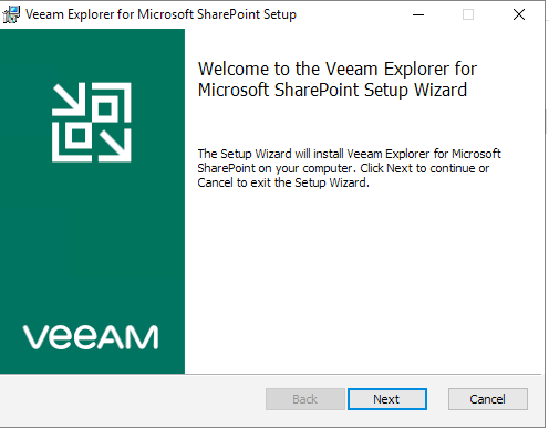

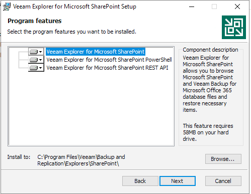

Here is the Sharepoint plugin installer

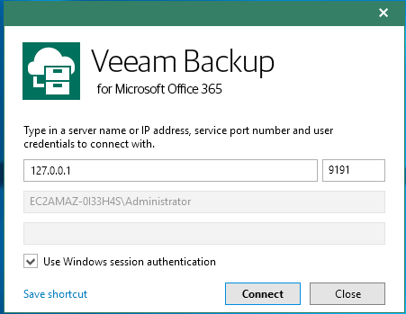

Let’s rum the Veeam Backup for Microsoft Office 365 application (the top shortcut).

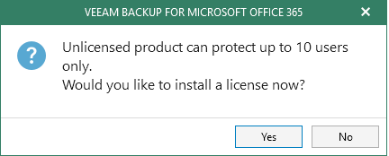

Hit connect, to have the application launch. As we are using the trial version, this allows us to backup 10 users only. We are warned about this as the app launched. AS we don’t have a license right now, we are going hit no.

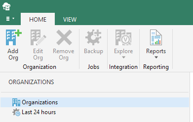

Now, we need to add an Org by clicking on the “Add Org” in the top left of the VBO Window.

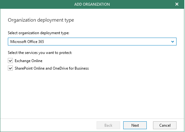

We are then prom[ted to choose the Organization Deployment Type. In our case, we want to backup from Microsoft Office 365, including Sharepoint and Exchange Online, so we are going to keep the defaults.

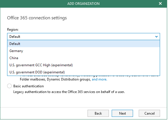

On the next screen, we need to choose the region that we are operating in. For most folks the default region should be fine.

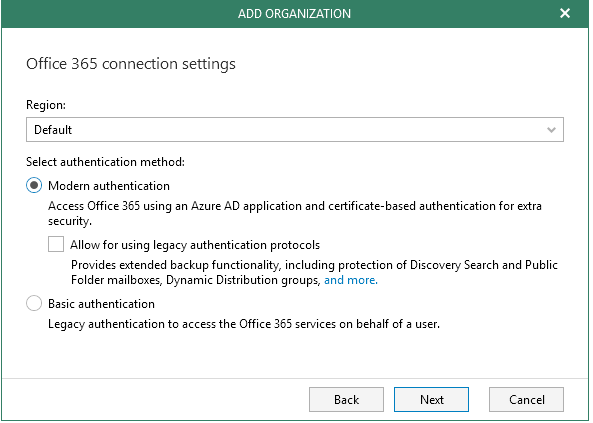

For maximum security, we are going to use the Modern Authentication. Ensure that you leave the “Allow for legacy authentication protocols” unchecked.

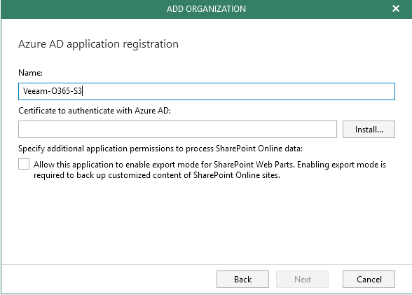

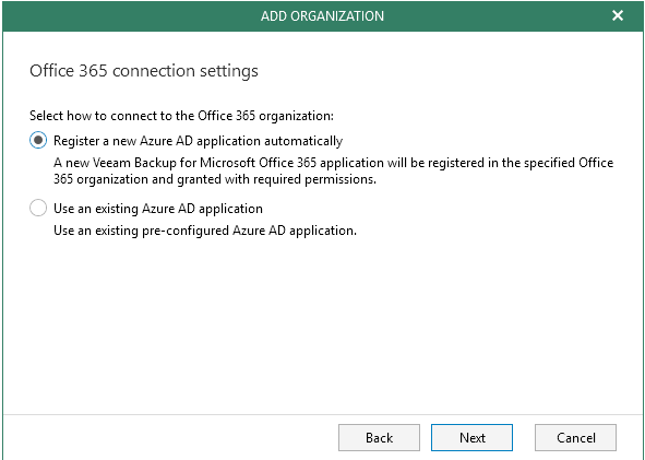

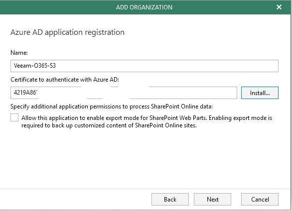

At this point we need to either Register a new Azure Ad application, or Use an existing Azure AD application. Let’s proceed with registering a new application.

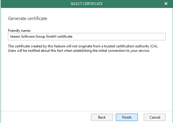

Give your Azure AD Application a name, and select to install a certificate by clicking install.

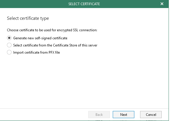

As you can see from the screenshot, we are going to generate a new self signed certificate

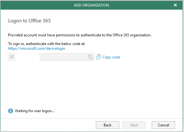

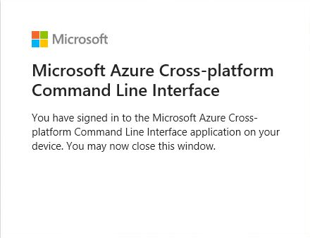

Ensure you have the code that is shown in the screen shot above. Yours will be different than mine. Proceed through the authentication steps. Obviously, I cannot show them here for security reasons. If you have done everything correctly, then you should see the following.

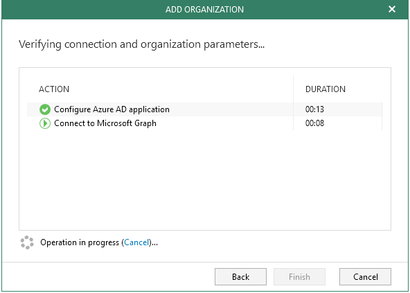

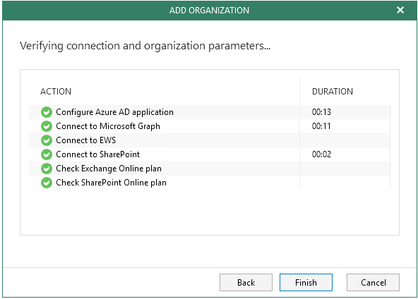

Once you hit next, VBO will begin configuring the application in Azure AD.
If everything goes as planned, then you should see something like this.
Hit finish, and you now have an organization configured in Veeam Backup for Office 365, so we now need to get on with configuring our first backup job.
