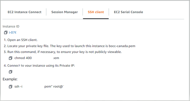

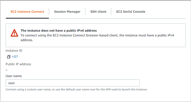

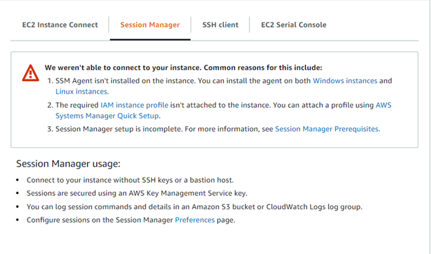

Let me build out the scenario here. Your company is taking a cloud first approach to the IT infrastructure, and as a result one of the first servers to be moved to the public cloud (in a private VPC) is the IGEL Universal Management Suite Server. To reduce cost, we chose to install the UMS on an Ubuntu Linux server without GUI. If you are familiar with AWS, the ‘console’ access to Linux servers is generally only available via SSH.
As you can tell from the screenshots above, the only method we have to access the server is via SSH. Out of the box, SSH really does not have any “fancy” GUI available, so let’s change that.

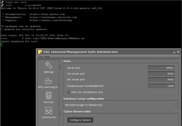

sudo /opt/IGEL/RemoteManager/RMAdmin.sh
After executing the command, you will be prompted for your password. Enter the password, and in a perfect world, everything will work as expected and the console will launch. We are not so lucky.

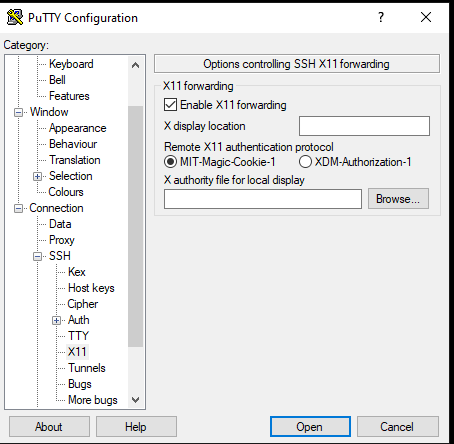

Now we need to fire up putty, and enable x11
Now that we have Xming installed, and X11 configured on both the server, and on the client, let’s try to launch the UMS administrator console again.
Success! Profit?
