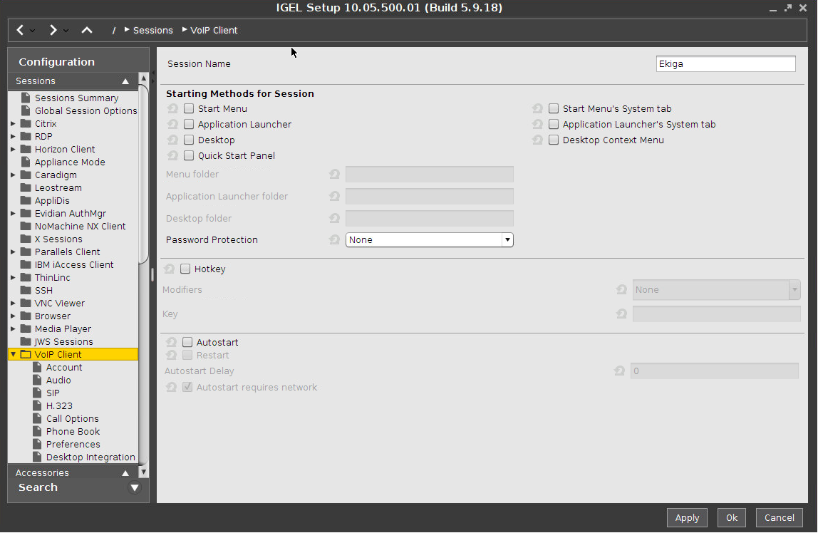

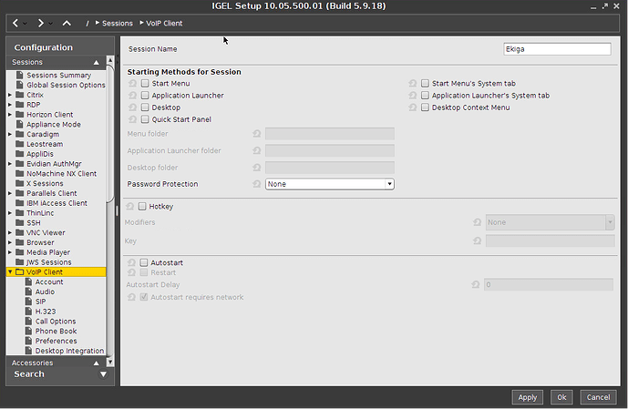

The first thing we need to do is enable the Ekiga VOIP client within the IGEL OS Profile

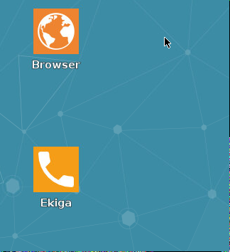

For this configuration, I am going to place the icon for the VOIP client on the desktop of my IGEL OS workstation.
For now, that’s all we need to do on the thin client, so let’s turn our attention to the Cisco Call Manager.

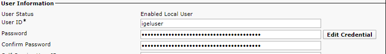

  1. We need to create a local user for use with the IGEL VoIP client. In this case, I created a user called ‘igeluser’
    image791×112 3.28 KB

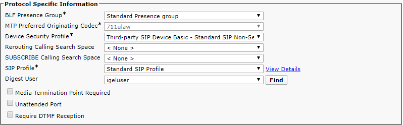

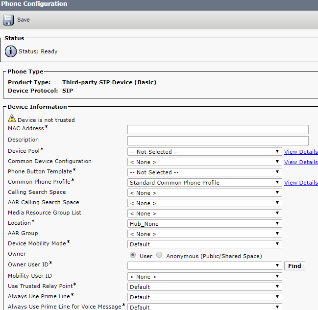

  2. We now need to configure the Protocol Specific Information section within the device configuration. It is very important that you choose the digest user that you will be using to log in to the SIP phone.
    image798×248 12.4 KB

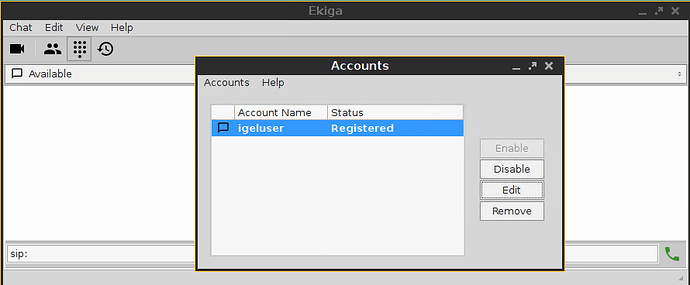

  4. Success?
image890×368 56.2 KB

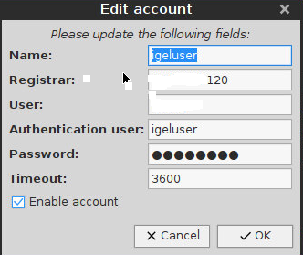

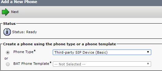

Once launched, we need to edit the Account information on the SIP client, and ensure it is enabled. The Registrar is a call manager subscriber, and the authentication user is the usr you created in step 3.
For Type of phone, choose Third-Party SIP Phone basic, and fill in the mandatory fields.
image649×633 21.7 KB
The MAC address can be anything here, as we are going to be assigning the device to a user. Third-party SIP phones do not use MAC address values for registration with Call Manager

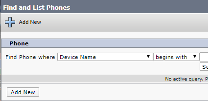

Go to Device - phone and Add New
