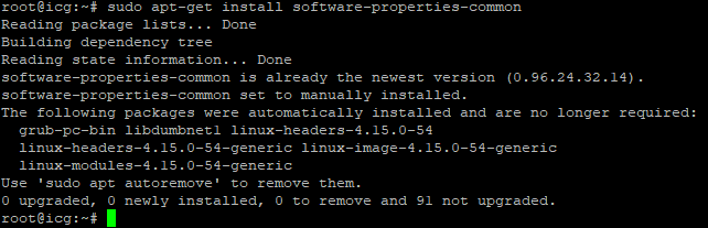

sudo apt-get update
sudo apt-get install software-properties-common

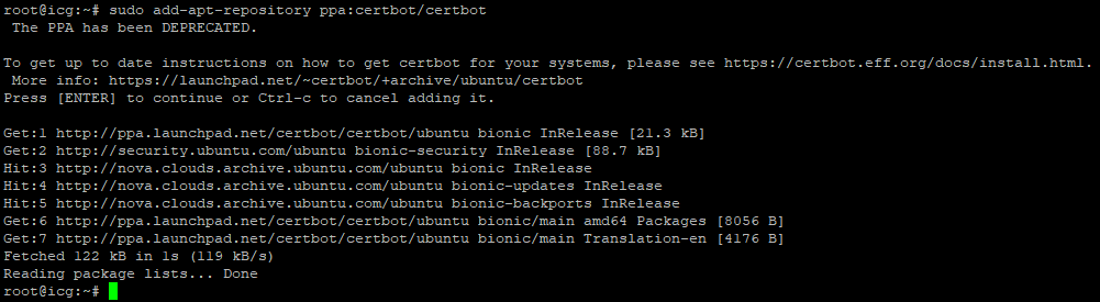

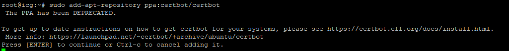

sudo add-apt-repository ppa:certbot/certbot
image1025×103 4.59 KB
Hit enter to add
image1001×275 9.52 KB

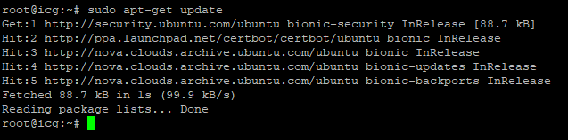

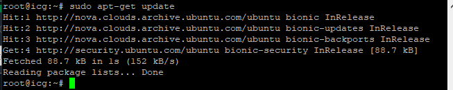

sudo apt-get update

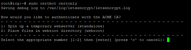

Now that it has been installed, we need to configure Lets Encrypt by running the install and answering a few questions.

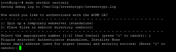

sudo certbot certonly
We want to spin up temporary webserver (standalone), so we are going to choose option 1.
We are then offered the chance to enter an email address for urgent renewal issues of the cert. This is highly recommended in a production environment.

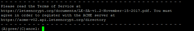

We then need to agree to the terms of service of using the Lets Encrypt server, so hit A to agree

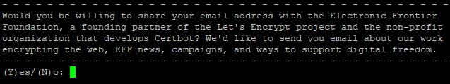

You need to decide if you are willing to share your email address with the Electronic Frontier Foundation. A founding partner of the Let’s Encrypt project and the non-profit organization that develops Certbot.
Now we need to chose the domain that we plan to use for our IGEL Cloud Gateway. It is very important that you verify that your DNS is configured correctly, or this will fail. For our purposed, we are going to use icg.mybrokencomputer.net as our hostname

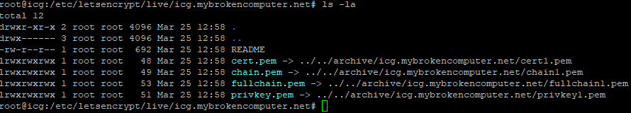

Now we have the certs we need. To verify, navigate to /etc/letsencrypt/live/yourdomainname/ and you should see your certificates.
image890×160 5.67 KB

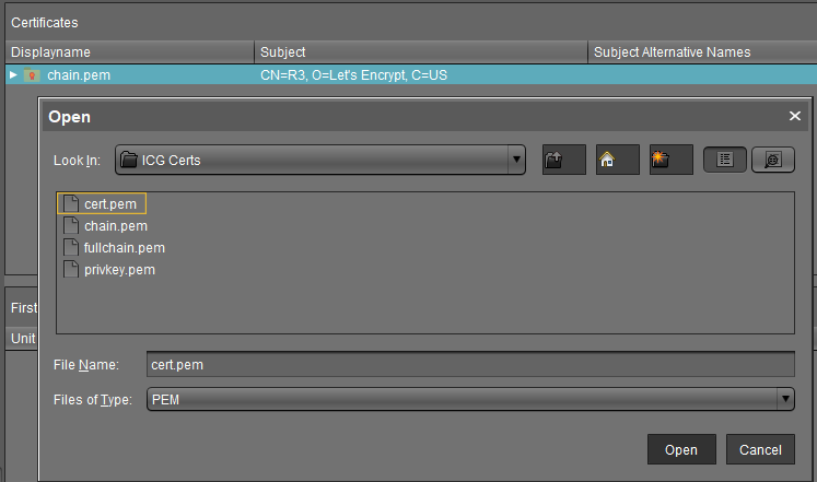

In UMS go to UMS Administration, Cloud Gateway Options. Here are we are going to import our root certificate from the certs we just downloaded by clicking on this icon in the top right.
The first cert we need is chain.pem, so let’s import that.
image1012×97 3.94 KB

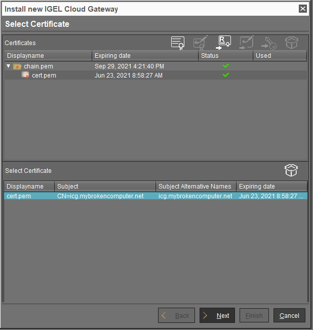

OK, that looks good. We now need to right click on that certificate and choose
Import Signed Certificate
We then browse to the certificate location and choose cert.pem
image747×441 14.1 KB
Our cert chain should now look like this.

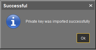

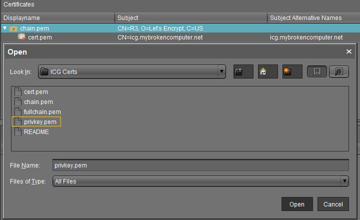

The final step in the certificate process is to import the decrypted private key. So right click on the cert, and choose
Import Decrypted Private Key
We are going to choose privkey.pem
image720×440 15.7 KB

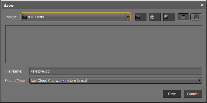

Now we are ready to export the keystore.icg file that the ICG appliance really needs. We need to right click on the certificate and choose
Export certificate chain to IGEL Cloud Gateway key store format
image711×355 9.27 KB
Save the cert somewhere that it is easy to locate, as we will need it shortly.

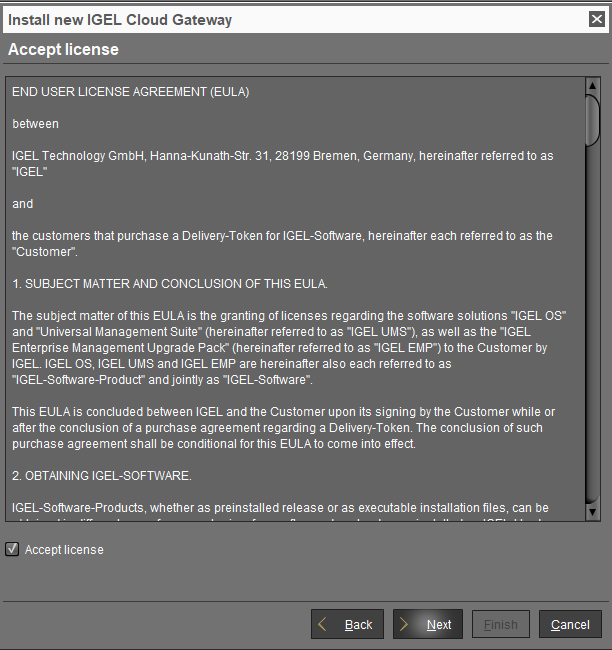

Accept the IGEL license agreement
image612×650 22.7 KB

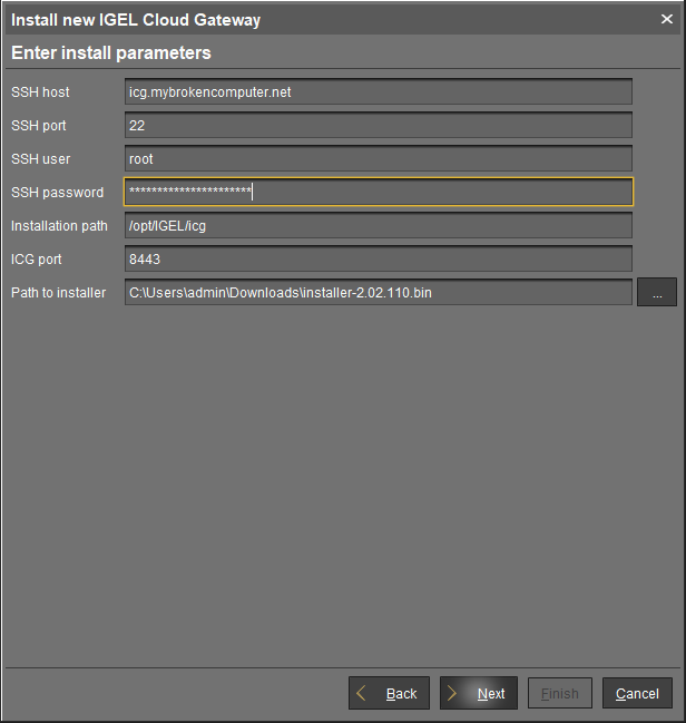

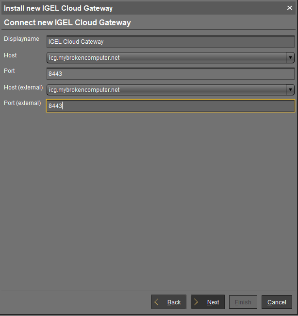

Now we need to provide credentials to our ICG server, and the path to the .bin file that we downloaded earlier.
image616×649 11.2 KB

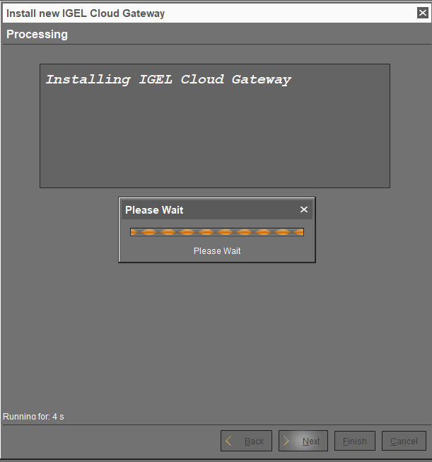

Hit next, and we are off to the races!
image611×653 9.68 KB
image618×650 7.58 KB

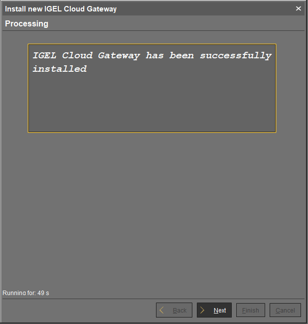

49 seconds! Not bad.
image614×650 10 KB

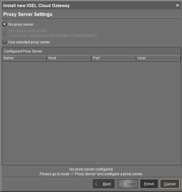

Configure a proxy server if you have one.
image615×651 12.4 KB

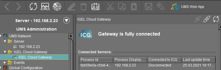

After all that, we are done!
image748×238 21.1 KB
