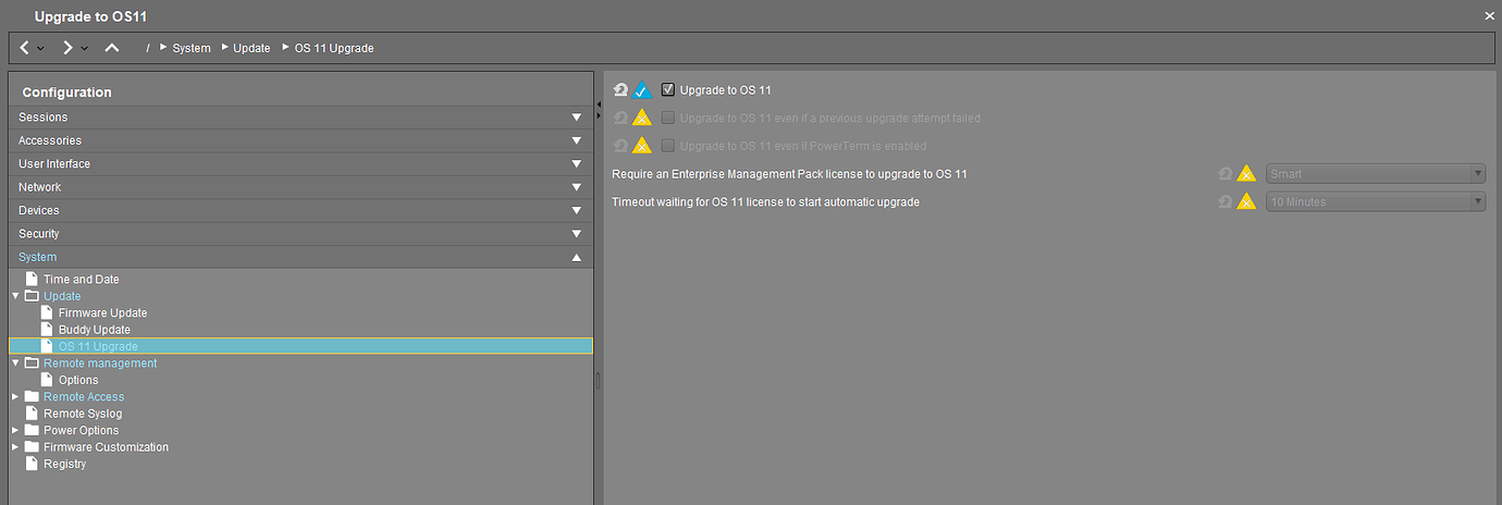

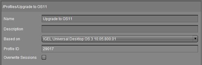

First, you need to ensure that all our your version 10 thin clients are running firmware version 10.05.800. You need to have this version of the firmware downloaded to your UMS (both UMS5 and UMS6) in order to create the needed profile, and configure the “based on (see screenshot below)” so that the option to upgrade to OS 11 is present. We also need to define the profile that we will use to actually upgrade the thin client from OS10 to OS11.
As you can see, the profile is pretty vanilla, with just the Upgrade to OS11 enabled, along with a couple of minor configurations set for remote access and remote management.

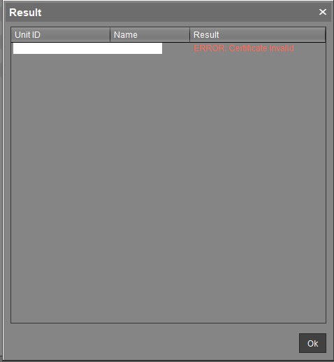

Now that the thin clients are on the correct version of IGEL OS10, we need to get rid of the certificate that was installed as part of registering to UMS V5. If you try to register a thin client that had previously registered to UMS5 with UMS6, you will get a certificate invalid error.

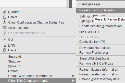

The quickest, easiest way to do this is to factory reset the thin client device
Right click on the directory that contains all of the thin clients you want to reset then go to Other Thin Client Commands, and choose factory reset. Be warned that doing this WILL remove them from UMS. This is a good thing, as we want to bring them into UMS6 anyway. The factory reset process took about five minutes or so.

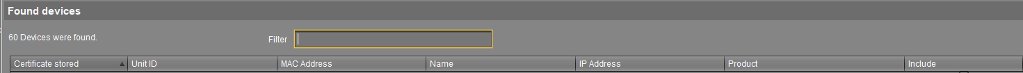

This process will remove the device from UMS5, which is a good thing, however you need to make sure that you have a solid discovery process in place for when you want to add the now factory default thin clients into UMS6.
Once the factory reset process has completed, we need to bring the now “vanilla” thin clients into UMS6. I am lucky in that all my thin clients are on separate subnet so I can scan that subnet, and sort by the “Certificate Stored” column. Any clients that do not have a certificate stored, can be pulled into UMS6.
