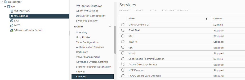

The first thing we need to do is enable both SSH and ESXi Shell on the host that you plan to upgrade.
Remember to stop these services once the upgrade has been completed as these are potential points of access for bad guys out there.

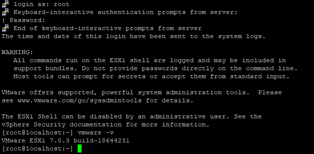

We now need to reboot the host by issuing a simple reboot command from the command line
Once the host comes back around, login to the SSH console and verify that the upgrade has been successful by issuing the VMware -v command once again.
